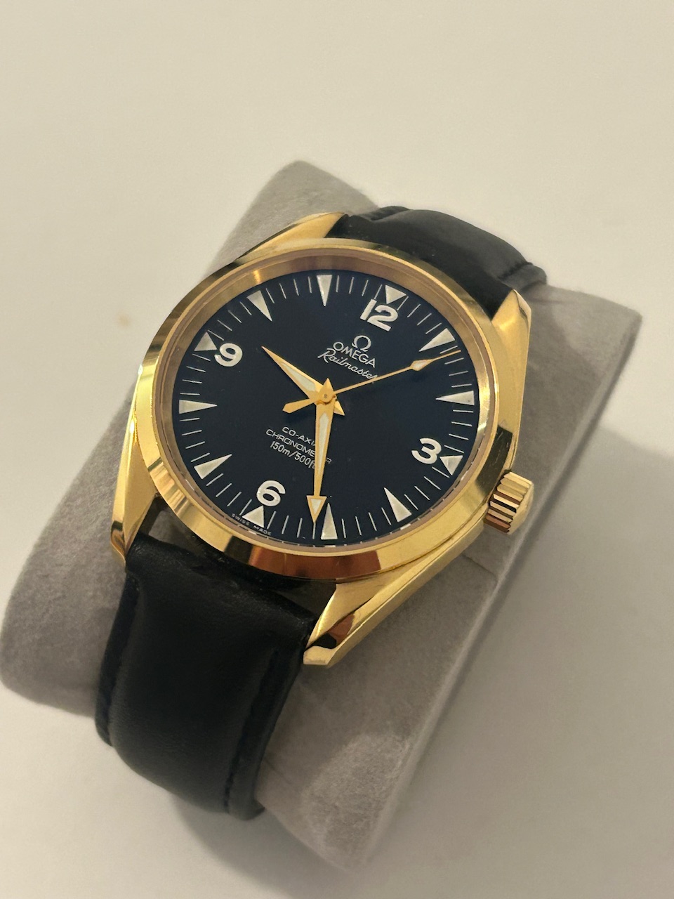

karbon74 364 Posted April 16, 2024 Railmaster gold plated with a 2824 1 Share this post Link to post Share on other sites

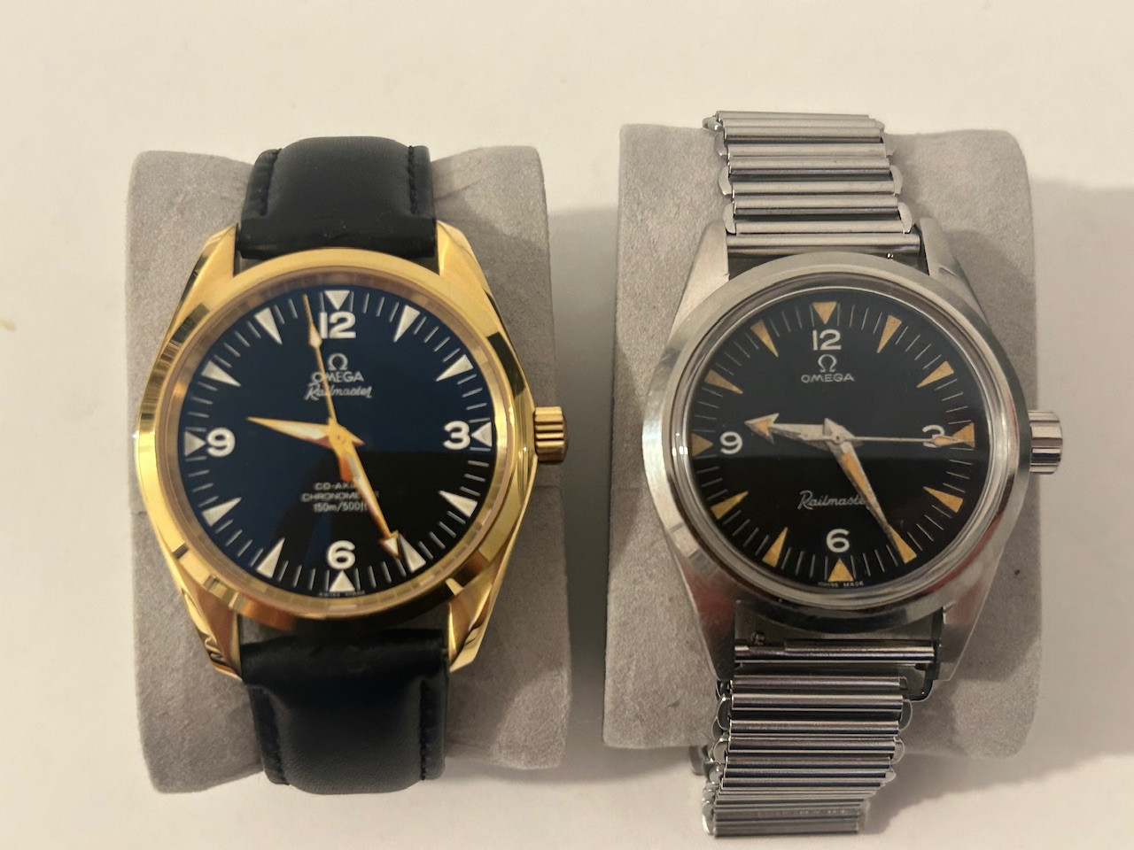

karbon74 364 Posted April 21, 2024 Finished my Railmaster CK2914 OMG this was so hard. 2 Share this post Link to post Share on other sites
karbon74 364 Posted April 21, 2024 On 03/07/2022 at 19:42, APjumbo said: Proof I’m not a watchmaker. Definately missing the OCD gene. Found this beauty though. Hopefully it organizes me more better Buy a small surgeon tray. And get in the habit of putting the tool you just used in it 1 Share this post Link to post Share on other sites
karbon74 364 Posted April 21, 2024 (edited) 14 hours ago, karbon74 said: Finished my Railmaster CK2914 OMG this was so hard. For those interested, this is an San Martin donor watch, with a BiVintage dial the Bi dial is 31mm and fits the SM. however it needs to be sanded down to 0.37mm for the stem to align…I snapped two stems finding that out… The tube however is standard 2.5mm. A 6.5mm crown works. Ideally, I will need to swap the sapphire crystal to a acrylic armored crystal, but I am happy as is. It looks like a restored 2914 with a new crystal Edited April 22, 2024 by karbon74 Share this post Link to post Share on other sites

karbon74 364 Posted April 28, 2024 (edited) On 26/04/2024 at 06:56, shinynewbling52 said: Awesome build! Looks great. I have the same missing OCD gene as that's what any tools I'm using look like whenever I work on anything. I can't find things I just used because I put them just wherever my hand feels like putting them and with watch things my sleeves and arms knock tools and watch parts around........ Everything matches perfectly on your Railmaster. It's just perfect. For it to be perfect, I should replace the sapphire with an armored acrylic crystal (the one that had a metal tension ring) and a Naiad crown but I am happy with it as is. Some Railmasters have been restored with a sapphire and Naiad crowns are hard to find with the proper tube Edited April 28, 2024 by karbon74 Share this post Link to post Share on other sites
