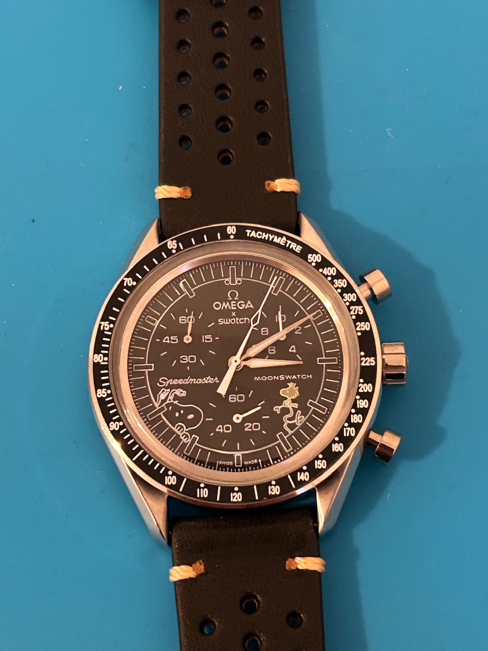

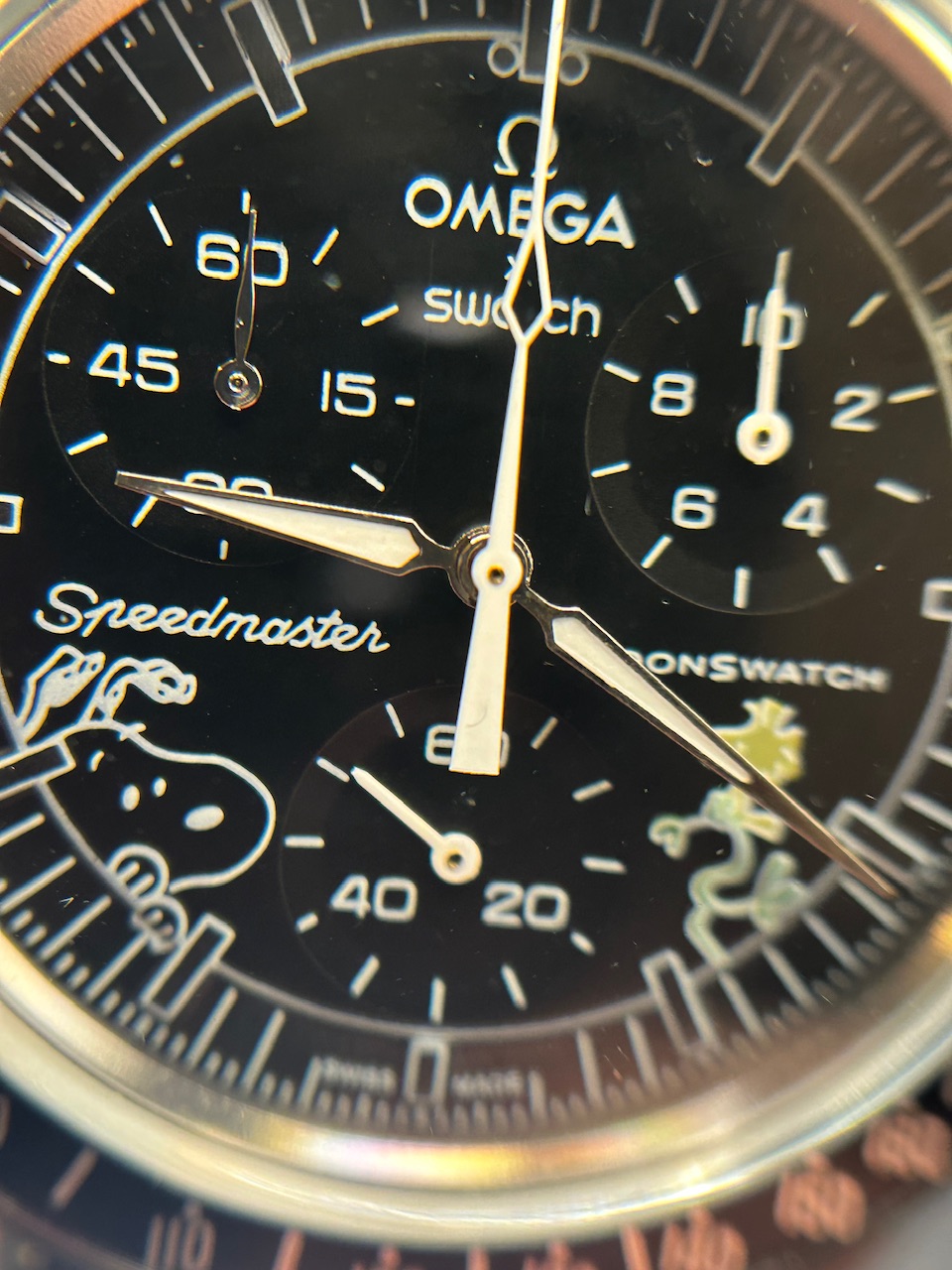

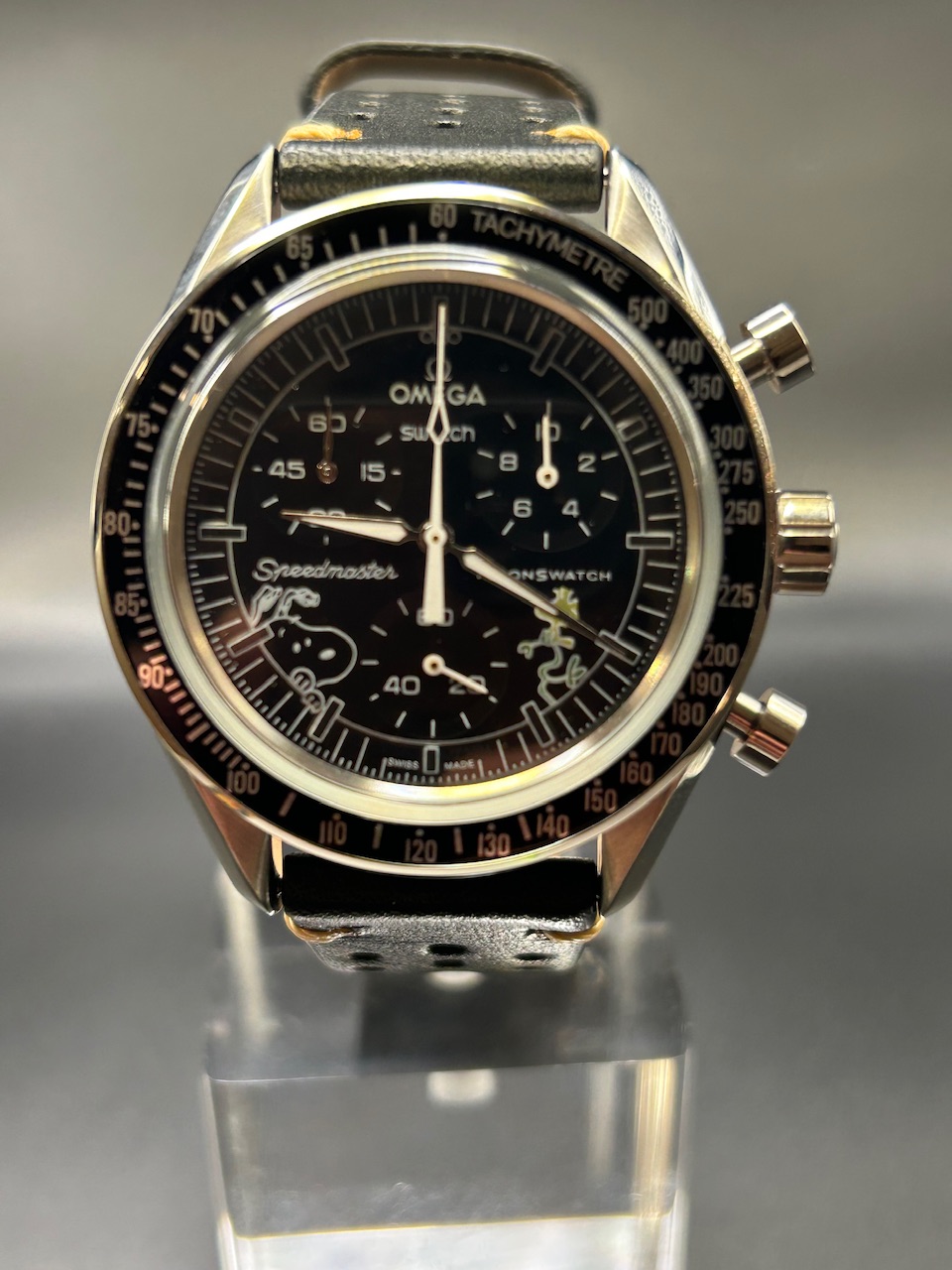

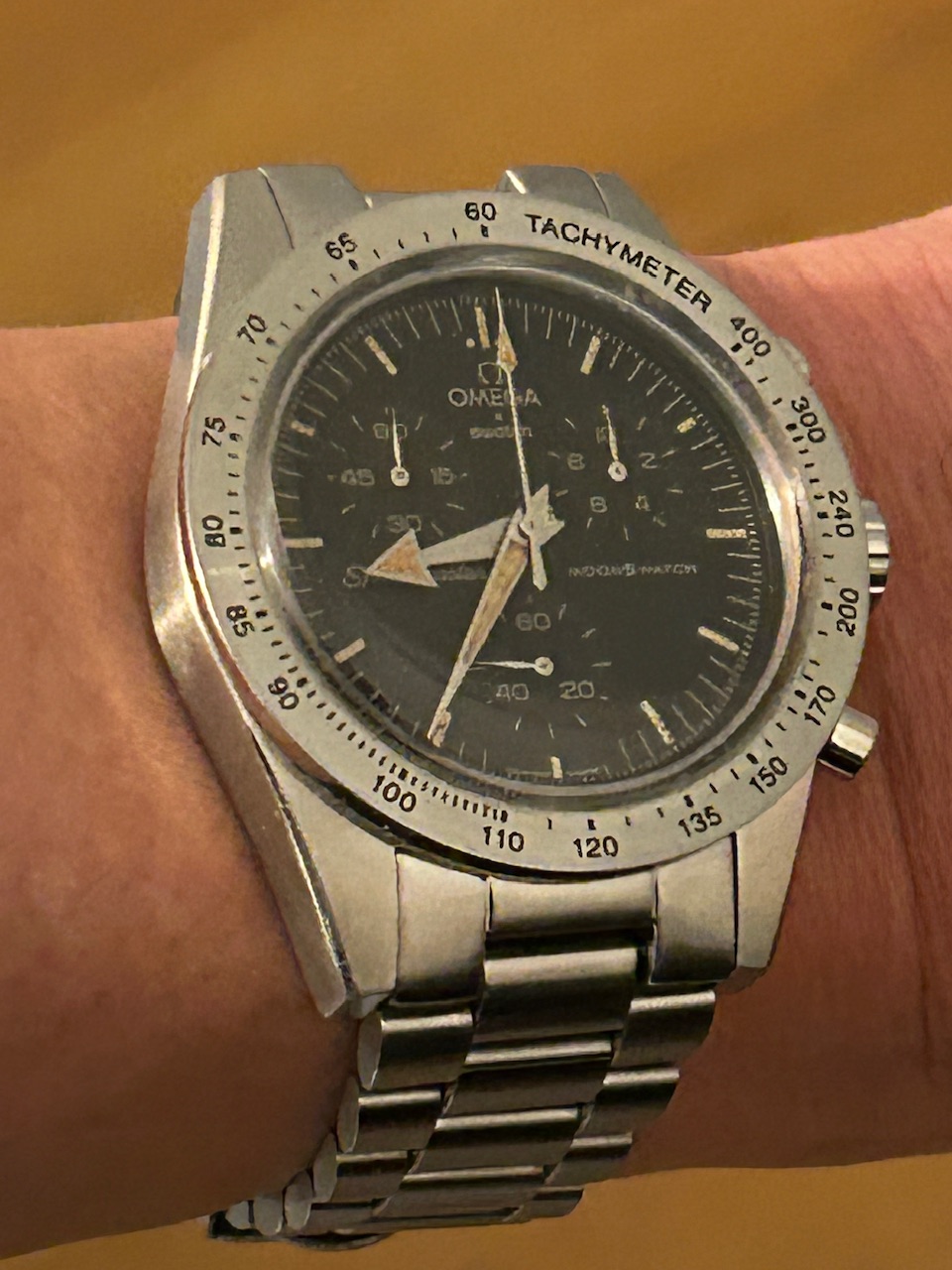

On 22/12/2024 at 15:30, karbon74 said:
First Snoopy In Space :) prototype
This one is a special one as prototype
Prototype PKF-FSIS-1
- Leaf arrow hands, white central seconds
- neo vintage case without crown guards
- non canon dial with Snoopy and Woodstock
- 10H subdial sword, 2H 6H white baton
- polished chapter ring
- low dome mineral crystal
- omega branded crown
- black vintage rally leather strap with an omega branded buckle
karbon74

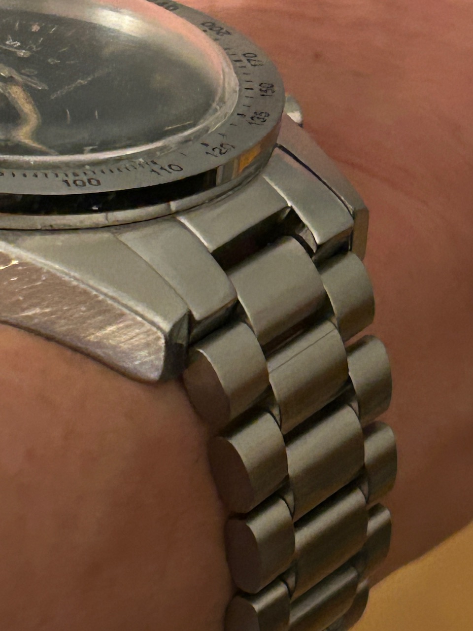

The challenge with these builds, especially the 1957 is to find a good bracelet
i never found one…so I made it :()

ryaku
The gap looks visible between the endlink and the first link.
Is there any semi decent rep bracelet that would fit Uncle Seiko endlinks?
karbon74
Those are the Pagani endlinks on the US bracelet
Indeed there is a gap, but honestly, on wrist it’s not obvious
ryaku
Interesting, thanks for confirming.
I was just wondering if the way around was possible being cheaper somehow: US endlinks with cheap bracelet from Pagani or watchdive for instance
karbon74
Another option is to use the stock Pagani.
you will need to thin it using a belt sander, and mod the butterfly clasp to a deployant

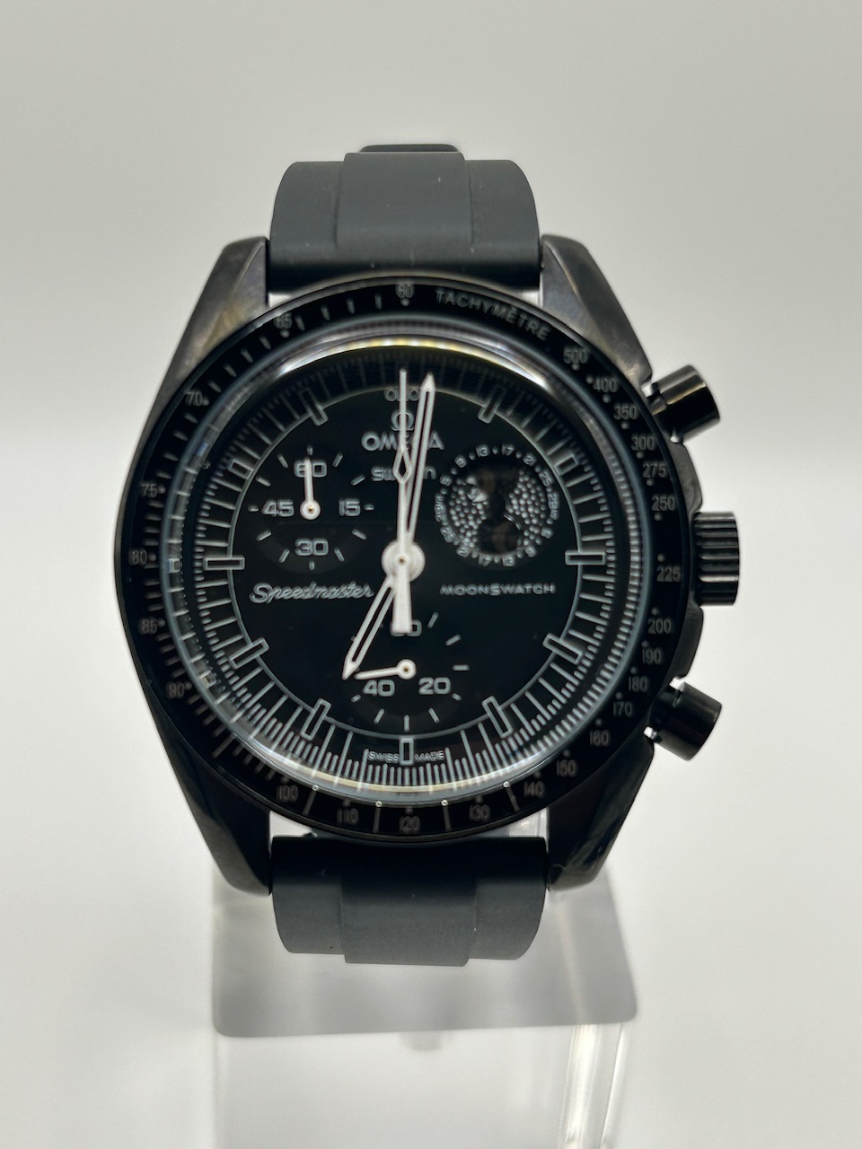

karbon74
looks nice with FKM rubber. Quite a mean look to it
