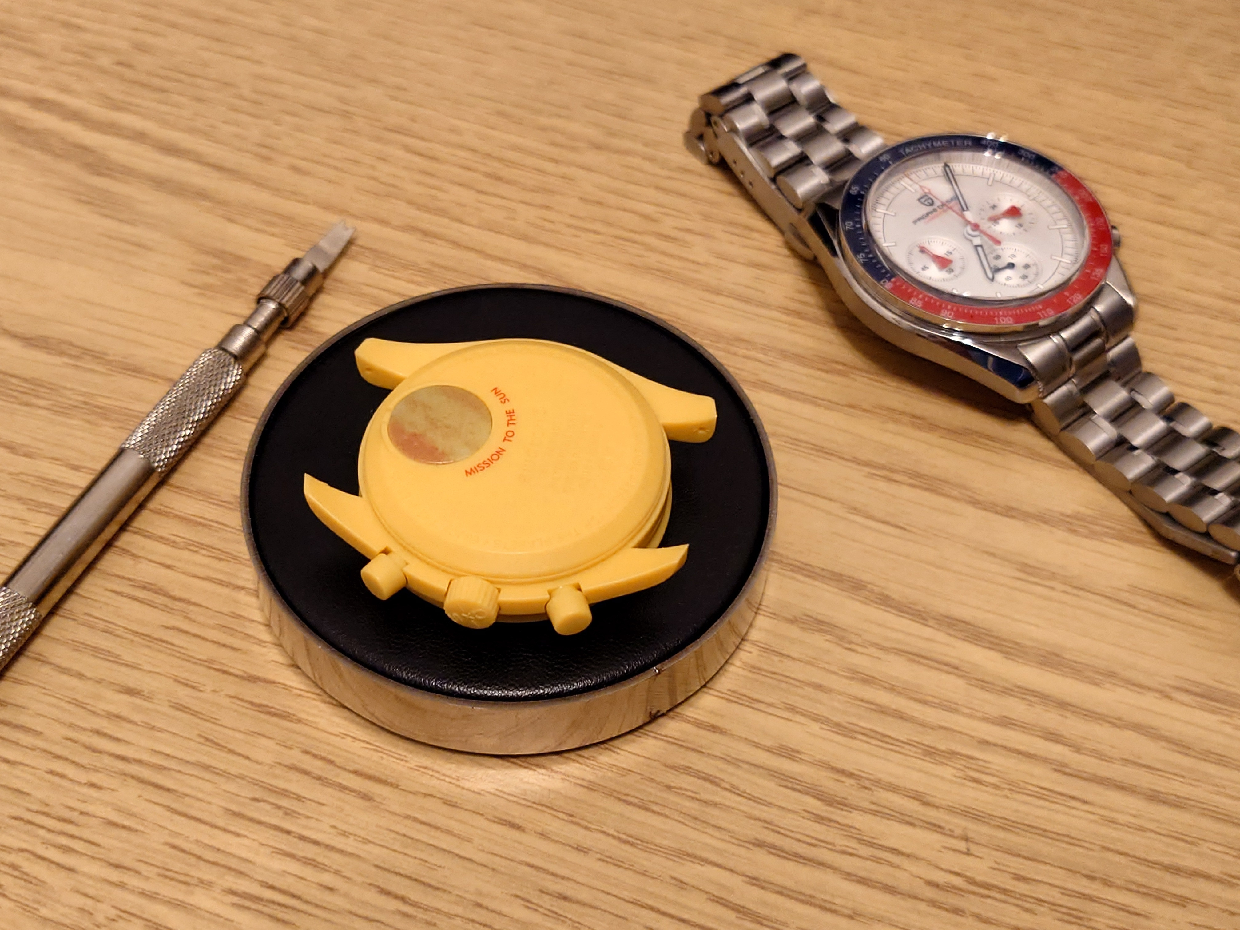

On 01/02/2025 at 00:12, whoischich said:
These are fantastic looking mods. Is the process the same if using a gen moonswatch or are the parts different?
it’s different
for a gen you will have to destroy the gen case, as the movement is sealed inside…so think well before you do that
on the other hand, the movement swap is much simpler as you don’t need to freeze the 2h hand, nor adjust the pushers
whoischich
Thanks for that - will need to think about whether it's worth it or not. Perhaps with a Mission to Earthrise or similar, could be a good look.

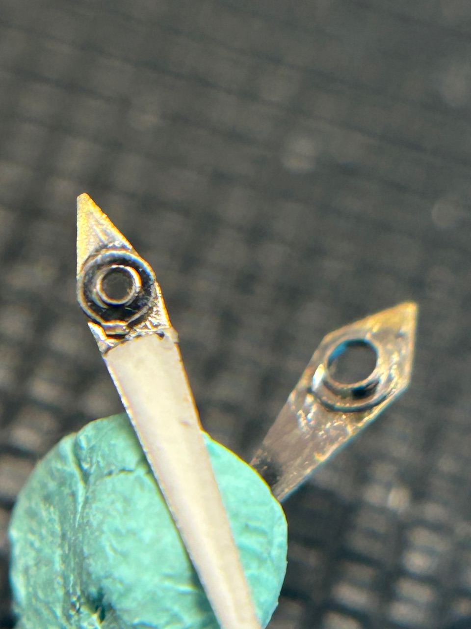

Has anyone encountered this problem where the small needles have come loose?
What fixing do they have?
https://clickpix.org/image/Imagen-de-WhatsApp-2025-02-15-a-las-12.25.38-4f4f7a47.2LCoGn
https://clickpix.org/image/Imagen-de-WhatsApp-2025-02-15-a-las-12.25.38-4c0c4465.2LCIL3
you need to tighten the collet.
there are special tools to do so on AliX
or you can very carefully use a pair of ceramic tweezers to squeeze the collet. Put a hair (or a very tiny wire) in the hole before squeezing.

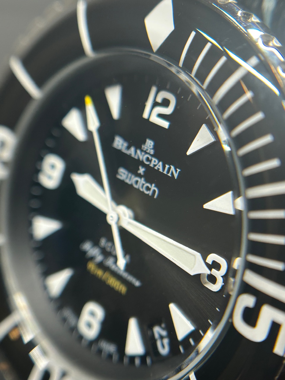

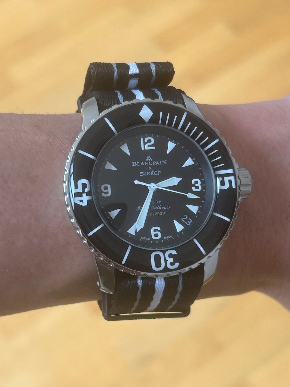

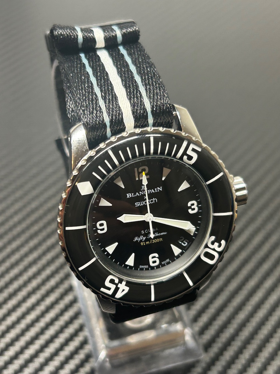

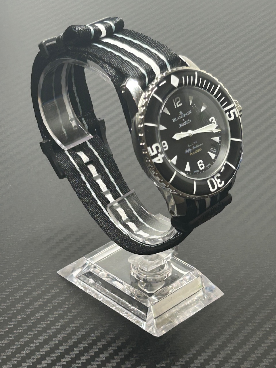

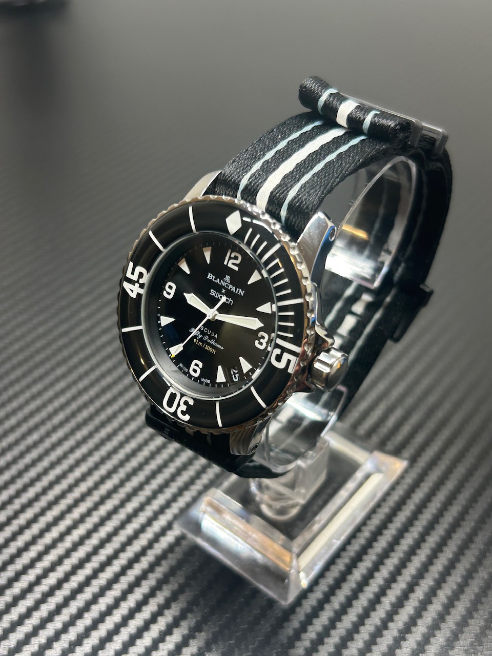

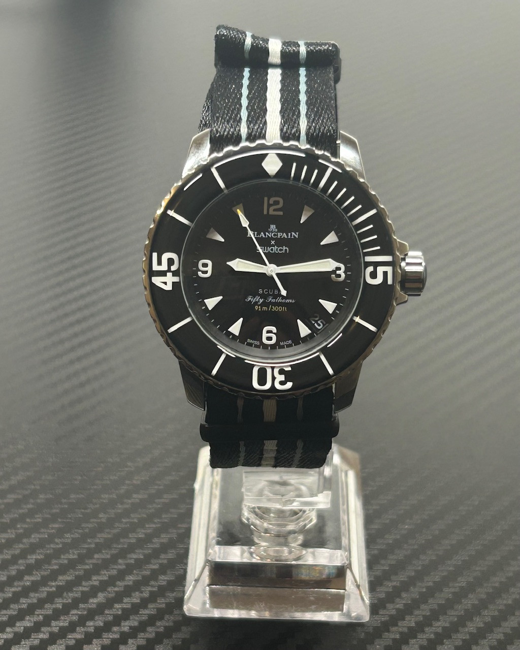

Not a MoonSwatch but…
Behold the first BlancPain MetalMod
karbon74
Redfire1066
@karbon74 … another cracker of a conversion  … was this one easier?   :thumbsup2:
karbon74
No
this one is 10x more difficult

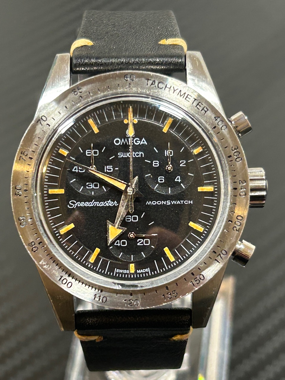

On 18/04/2024 at 03:30, karbon74 said:
Neo Vintage « Steampunk »
This is more my style man!

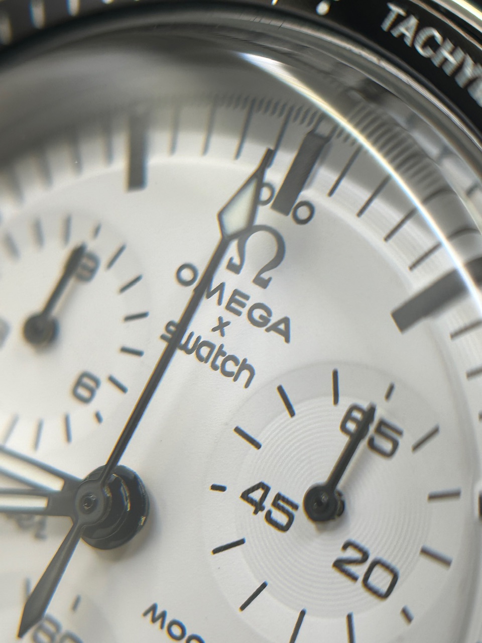

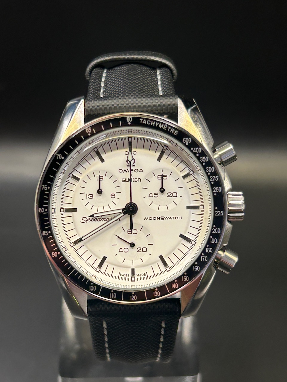

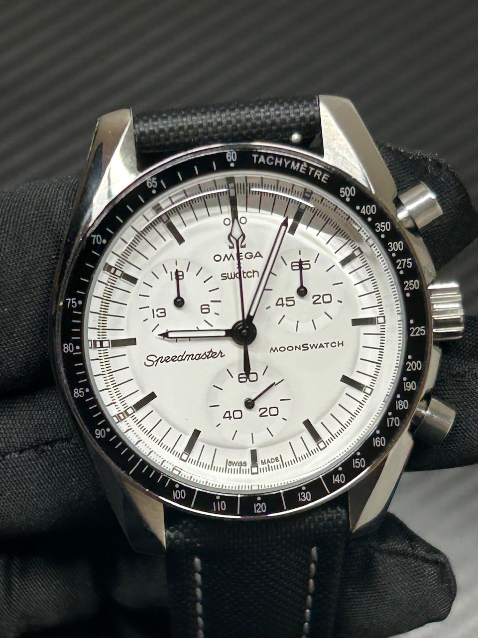

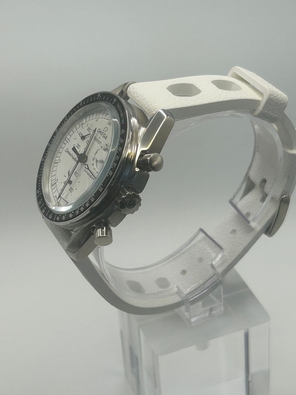

white dial 1965
arout
On 15/04/2025 at 23:42, karbon74 said:
white dial 1965
That Omega x Swatch MoonSwatch is a sleek beauty. With crisp white dial, silver case, and that black nylon strap just ties it all together perfectly. It’s got that retro NASA energy with a fresh twist. Super wearable,  full of character and definitely a head-turner.
