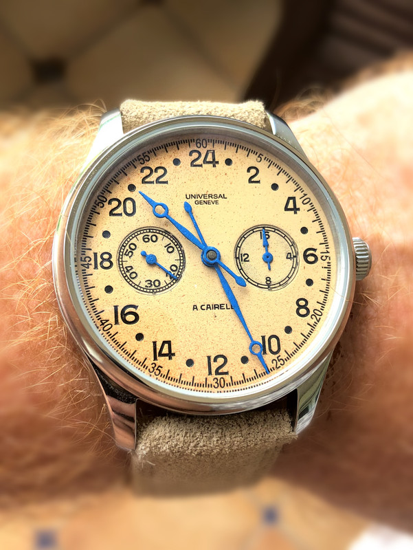

frankfrank 1,125 Posted May 20, 2018 Hello Gents, I'm looking for a little help sourcing a few parts on this build and also about the movement. I have a dial maker but have been unable to find:- 44mm single pusher case set ( ive contacted a few vendors and still waiting to hear back from phong and MQ)- Hands- movement (questions)Movement:- I have heard a 7753 clone will work. - will sub-dials line up correctly with either of these movements in a 44mm case?- do i need a special movement for a 24 hour dial or am i able to have one of the above movements modified to keep the correct time on that dial?Thank you in advance Logan Share this post Link to post Share on other sites

GenTLe 1,548 Posted May 21, 2018 I'd not try: 1st that watch is a manual winding column wheel crono from the 'forties (1940), so a 7753 will be way too thick. Second the pushers are at 2 and hidden coaxial to the crown (and you can't really do this, unless you take the movement from a rep Graham). Finally who knows if the hands pinion will be comparable with the Valjoux 55 gen movement. If ever I'd rather go for a SeaGull ST19 http://www.ranfft.de/cgi-bin/bidfun-db.cgi?10&ranfft&0&2uswk&Seagull_ST19 But, in the end, I don't see the point of investing too much time and money in such a difficult creation... Share this post Link to post Share on other sites
frankfrank 1,125 Posted June 15, 2018 On 5/21/2018 at 17:56, GenTLe said: I'd not try: 1st that watch is a manual winding column wheel crono from the 'forties (1940), so a 7753 will be way too thick. Second the pushers are at 2 and hidden coaxial to the crown (and you can't really do this, unless you take the movement from a rep Graham). Finally who knows if the hands pinion will be comparable with the Valjoux 55 gen movement. If ever I'd rather go for a SeaGull ST19 http://www.ranfft.de/cgi-bin/bidfun-db.cgi?10&ranfft&0&2uswk&Seagull_ST19 But, in the end, I don't see the point of investing too much time and money in such a difficult creation... Thank you for this info, just seeing this now... Does the SeaGull have a model with a 24hour hand or GMT hand? I see there s a model with 24h-hand at 6h on this link but with this dial i need a 24hr option Thanks for your help @GenTLe Share this post Link to post Share on other sites
GenTLe 1,548 Posted June 15, 2018 1 hour ago, frankfrank said: Thank you for this info, just seeing this now... Does the SeaGull have a model with a 24hour hand or GMT hand? I see there s a model with 24h-hand at 6h on this link but with this dial i need a 24hr option Thanks for your help @GenTLe Don't think so: http://chinesewatchwiki.net/Tianjin_Seagull#Current Share this post Link to post Share on other sites
frankfrank 1,125 Posted June 29, 2018 On 15/06/2018 at 17:07, GenTLe said: Don't think so: http://chinesewatchwiki.net/Tianjin_Seagull#Current just to confirm, this should work yes? http://www.mywatchcode.com/sea-gull-2557-automatic-mechanical-movement-gmt-date-function-movement-m8_p2839.html Then I can keep the 24hr dial and us the GMT hand for it, and have a working sub at 9 but faux at 3 which im ok with. Share this post Link to post Share on other sites
GenTLe 1,548 Posted June 29, 2018 I've no idea mate You should look into the tech pages of the seagull and check the placement of the pinions to see if they fit the dial. But then you don't know if the height of the winding stem will be ok and you'll have to check if it fits the case and, if so, you'll have to build a movement ring... So it's not the best option in my view... Share this post Link to post Share on other sites
frankfrank 1,125 Posted June 29, 2018 43 minutes ago, GenTLe said: I've no idea mate You should look into the tech pages of the seagull and check the placement of the pinions to see if they fit the dial. But then you don't know if the height of the winding stem will be ok and you'll have to check if it fits the case and, if so, you'll have to build a movement ring... So it's not the best option in my view... thanks again, ill sort it out.. . Share this post Link to post Share on other sites

frankfrank 1,125 Posted September 12, 2019 I couldn’t let it go... Share this post Link to post Share on other sites
