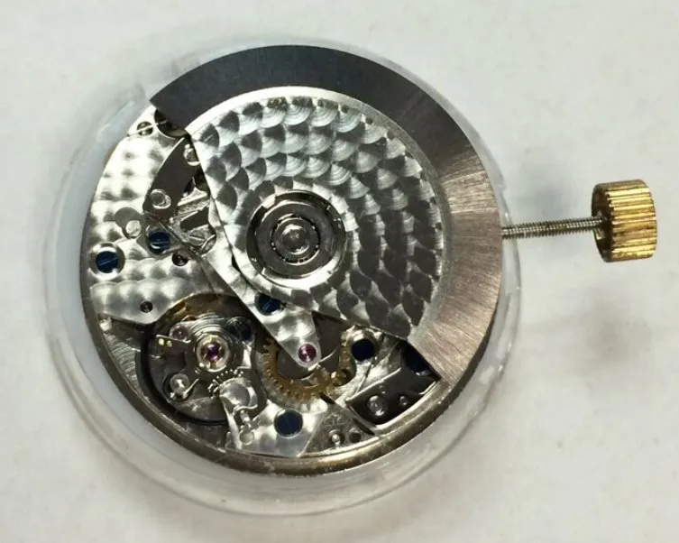

andy66 81 Posted September 5, 2023 I got this in Aug 2019 from the dealer I use near me,If I ask for the best he's always given me that so mostly I don't ask about versions or factory's,been talking with watchnut and it's not an old mvt and seems to be the same as the v4 OMF one I sold a week or so ago.can anyone help identify the mvt and any extra info. From now on I'm not buying without all the knowledge as it's a nightmare if you go to sell it on and you can't answer questions that should be basic . Cheers Share this post Link to post Share on other sites
splke 4,383 Posted September 5, 2023 cant sorry but it looks like seconds at 9 does the chrono work fully? Share this post Link to post Share on other sites
GenTLe 1,501 Posted September 5, 2023 If the chronograph works, then it's a modified 7750 like this, with a fake plate on top of the movement and a fake/modified rotor screw and rotor: https://www.aliexpress.com/item/1005005471654113.html 1 Share this post Link to post Share on other sites
andy66 81 Posted September 5, 2023 Yeah,seconds at 9.dial at 3 is working fine, Got it running now to check everything works right,my pal who I buy from has loads of makers and been in this game for 20+years,he uses some of the names ie VSF etc but this is from a maker with no name but produces good pieces,it seems this is the same mvt as the OMF V4 with the black balance wheel,that's my opinion,I've just compared the 2 and they seem the same....He's just back from the far East and he has told me some interesting stuff .....I'll wait a bit longer but the sub dial at six is moving now. 16 minutes ago, GenTLe said: If the chronograph works, then it's a modified 7750 like this, with a fake plate on top of the movement and a fake/modified rotor screw and rotor: https://www.aliexpress.com/item/1005005471654113.html I'm glad you lot know your stuff,I'd of never found that. Share this post Link to post Share on other sites
