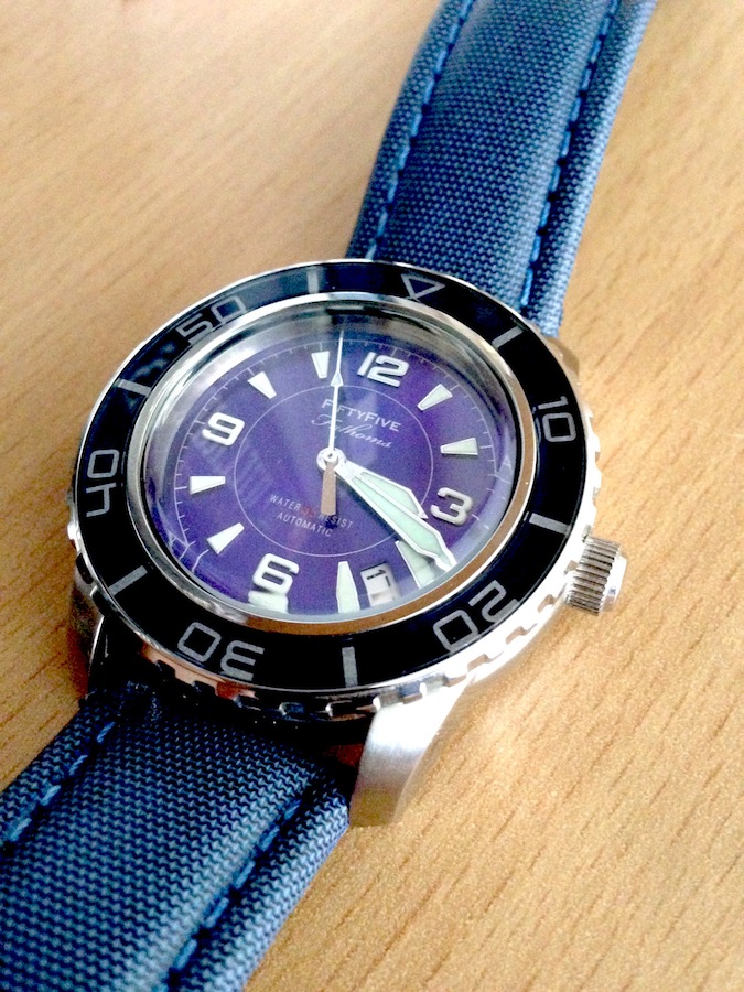

greg_r 81 Posted September 1, 2013 (edited) I'd been wanting a Seiko FFF for some time. I originally bought an snzh57 (the one with gold highlights) with the intention of doing just that, but I liked the standard watch so much I couldn't bring myself to mod it. So, given that I recently picked up a brand new snzh53 (the blue dial/bezel version) for cheap (£80) and Dagaz had a blue sunburst FFF dial available, I figured I'd give it a try. As this was my first attempt, I figured I'd do the dial only. If I liked the result, I could go back and do hands, bezel and possibly caseback later. So, this is what I started off with (not actually mine - I just grabbed this shot off the web): I was originally intending to do a tutorial, but there are several good tutes out there already (at least one on here and several on the gen fora - just google "FFF dial swap") so I decided I couldn't be arsed - especially as I had a tight timescale to actually do the job as I'm supposed to be working today (yes, on a Sunday!!! ) So, I removed the bracelet and out came my trusty Jaxa caseback opener. I then left the watch in a case holder while it ran down again. Once I had the back off, the biggest problem was removing the movement - it's quite a tight fit. I ended up using tweezers to grab the rotor right at the centre by the bearing and gently lifted the movement out. A few moments with the hands remover tool and I had original dial and movement separated. It was at this point that I realised I was an idiot (well, to be truthful, I always knew this - but I managed to prove it again). There were two versions of the dial at Dagaz. One for movements with crown at 3 (as per this watch), the other for movements with crown at 4. I knew this going in, but somehow I STILL managed to order the wrong one. Pillock! So, I removed the dial feet from the dial and then removed the circlip holding the daywheel in place (which I wasn't going to use anyhow given that the new dial only has a date aperture). I then used a couple of self-adhesive dial feet to hold the new dial in the correct position (fortunately other than positioning of dial feet the two versions of the dial are identical). Hands went back on (and man, it's fiddly to get the seconds hand back in place without bending it!), movement back in case, case back on. Done deal. The whole process - despite idiocy - still only took about an hour. The dial is actually more purple-ish than blue (which some would say is appropriate given my vehicular tastes ), but is still stunning. I kinda like the existing hands, but I think a change of bezel insert will probably be in order somewhere down the road. End result is as below (note that the pic doesn't do the dial justice - although it's purple-ish, it's actually less purple than the shot would suggest, it's also has a stunning 'sunburst' effect, which is completely lost in the photo. I'll take some better ones when I have time). I'm currently awaiting a blue sailcloth strap from Bradystraps, so the watch is back on the bracelet for the time being. I'll post some more pics when the de-rigeur strap has arrived. I'm tempted to do this mod again, buying a second snzh57 and going for the full black/gold dial, hands and lumed bezel package from Yobokies. For now, though, I'm very happy with the end result. I have a weakness for blue-dialed watches and I can see this getting a lot of wear. Edited October 7, 2013 by greg_r Replaced lame bracelet shot with quality sailcloth strap shot ;) Share this post Link to post Share on other sites

Pharmo 33 Posted September 1, 2013 Mate, thats actually stunning!!! Must admit i have been too lazy to do the mod myself...but should give it a go! Share this post Link to post Share on other sites

Foxindebox 465 Posted September 1, 2013 Nice one, that looks really great. Welcome to the FFF club Share this post Link to post Share on other sites

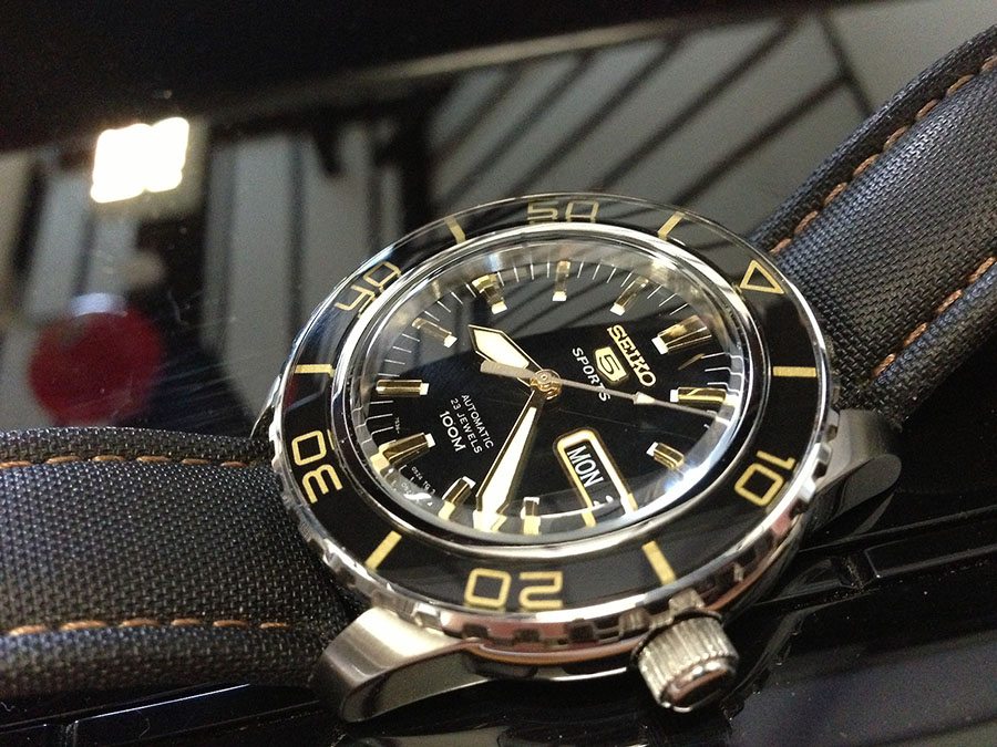

greg_r 81 Posted September 3, 2013 Greg, I love this. The FFF is my all time fav and in blue its a must for me at a later date when i have ordered the tool kit from RWG. New, as you well know but i am determined to build a FFF for myself. Recently i have ordered a few Seiko's from Ebay, i really like what they are doing, i think i will end up chasing a blue dial and having a go. PLEASE post the pic with the Brady strap as i am a firm believer in the strap been just as important as the watch when it comes to the look. Great stuff. Yup - photos with Brady strap will be posted as soon as it gets here - only ordered it end of last week, though, so it might be a few days yet. In the meantime here's my unmodded '57 on brady sailcloth... Share this post Link to post Share on other sites

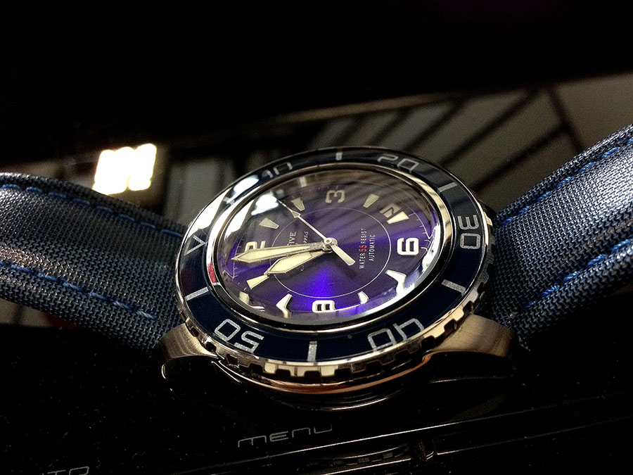

greg_r 81 Posted September 20, 2013 The sailcloth strap finally showed up - quick phone pic for now... Share this post Link to post Share on other sites
Ianp 0 Posted September 21, 2013 Looks great. Congrats. Share this post Link to post Share on other sites
